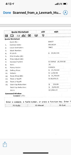

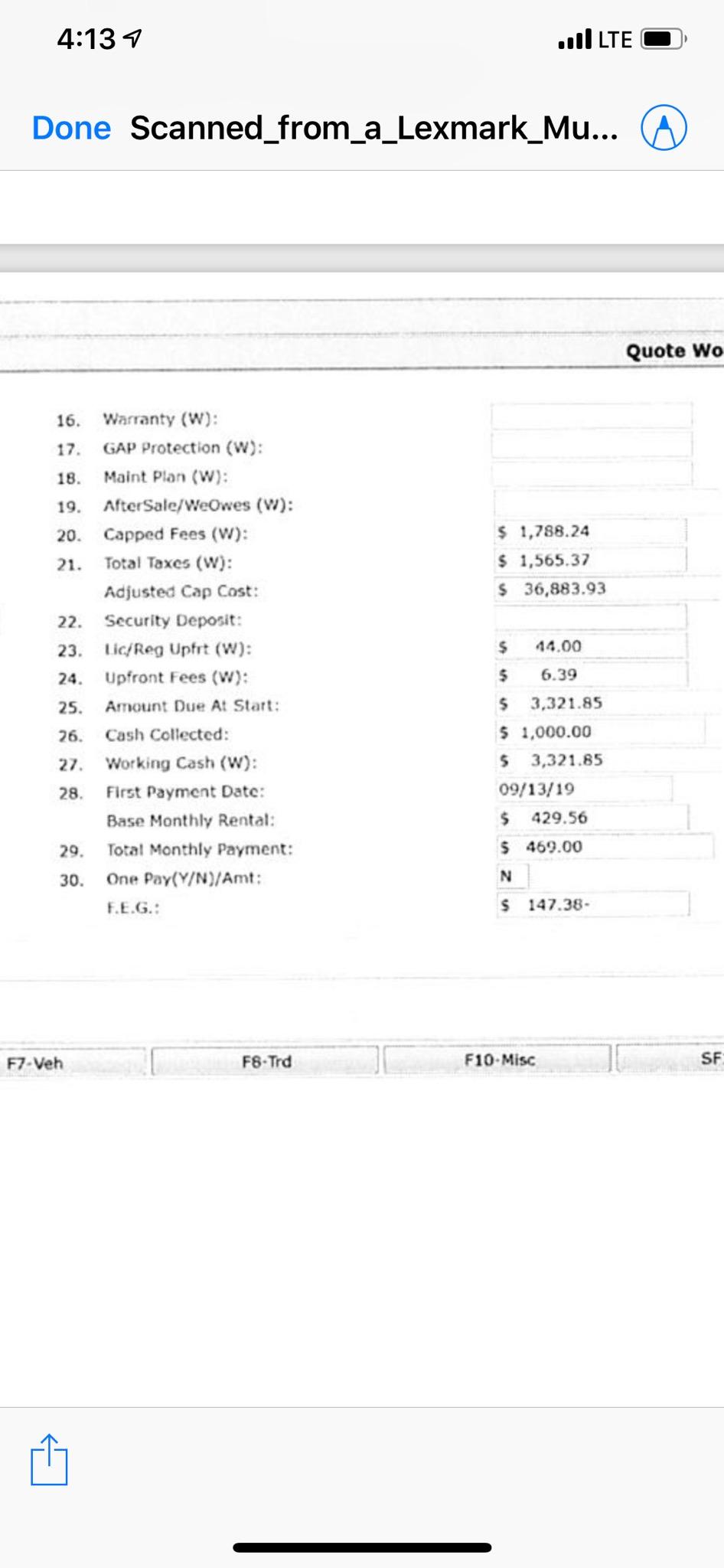

Yea i was think that to. Sorry my man for being late the sales guy left on vacay and didn’t get me the numbers till today. He offered 469 with 1000 down. Here are the screen shots of the quote.
This is for a trd premium 36 month lease. And I m planning on buying it after lease is done. You think i could still negotiate this deal further down???
