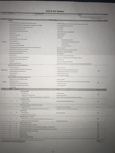

Interesting, I just looked at the full order guide and it appears that several higher trims (S4, S5, SQ5, etc) are available in just Premium now, rather than starting at Premium Plus? Theyâve moved some options around as well.
Is the black optic package available for the sq5 and s5 this year?
