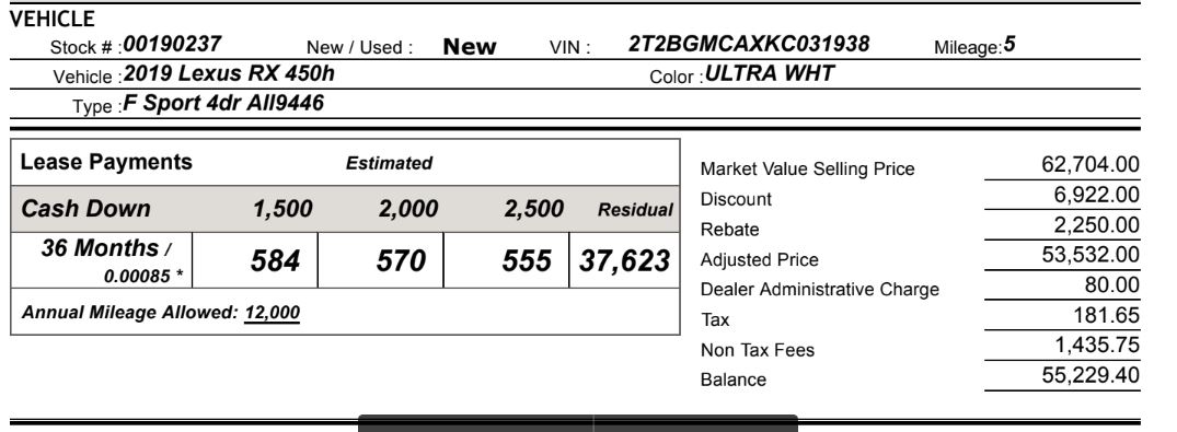

The quote he sent me is a little confusing…told him I want $0 down and gave him the number based on calculator and he gave me a quote that says 1500 cash down. Told him that 1500 is the drive-off including first month and he said yes it’s the same thing… Maybe it is but it just doesn’t feel right… Am I overthinking it?

this is all he gave me. He said the non tax fees include acquisition, registration, license, etc…The cap cost before rebate/incentives is 55778. I qualify for lease cash and college grad. I did confirm with him that i’m not putting $1500 down as down payment but rather as drive-off and he said ya.

hey guys. thanks so much for the input. I’ve explained it to him but he said something about system won’t be able to put MSD in. MSD issue aside I’m ok with the $0 down and monthly payment after tax. The numbers on there looks correct but the difference is his lease worksheet says “1500 down” and 584 a month, when that 1500 should be DAS (first month, tax on cap reduction, registration/dealer fees) but on that worksheet on the side it says non-tax fees the dealer said that ~1400 includes acquisition fee.
On the calculator the 584 is the correct amount if i do $1500 DAS with acquisition ROLLED into payment. If i pay acquisition upfront to be part of DAS then my monthly would be 560.

What do guys think of the deal. According to the calculator it has a score of 9.9
Please post the dealer’s lease worksheet so we can discuss intelligently.
I did in the above post. Or is that not it. I asked the dealer for the lease worksheet and thats what he gave me
A lease worksheet looks something like this…
I see. I dont even know how to ask the dealer since i asked for lease worksheet and he gave me that. What can i say to him now to let him know that what u posted is what im looking for
I’ve had to show a generic lease worksheet (like the one delta posted) to the dealer in order to get what I wanted.
You can do as Masher82 suggests or, print the one I posted to show the dealer. The dealer knows darn well what a lease worksheet is because they’re required to submit it to the fund provider as part of the documentation packageonce the lease has been finalized. They’re just playing stupid.
It’s so cal, there’s like 10 or 15 other dealers. Deal with a different dealer. Take the discount you got from A to another dealer where they’re more up front about leasing.
Ask for the lease breakdown, money factor before and after msd’s applied
